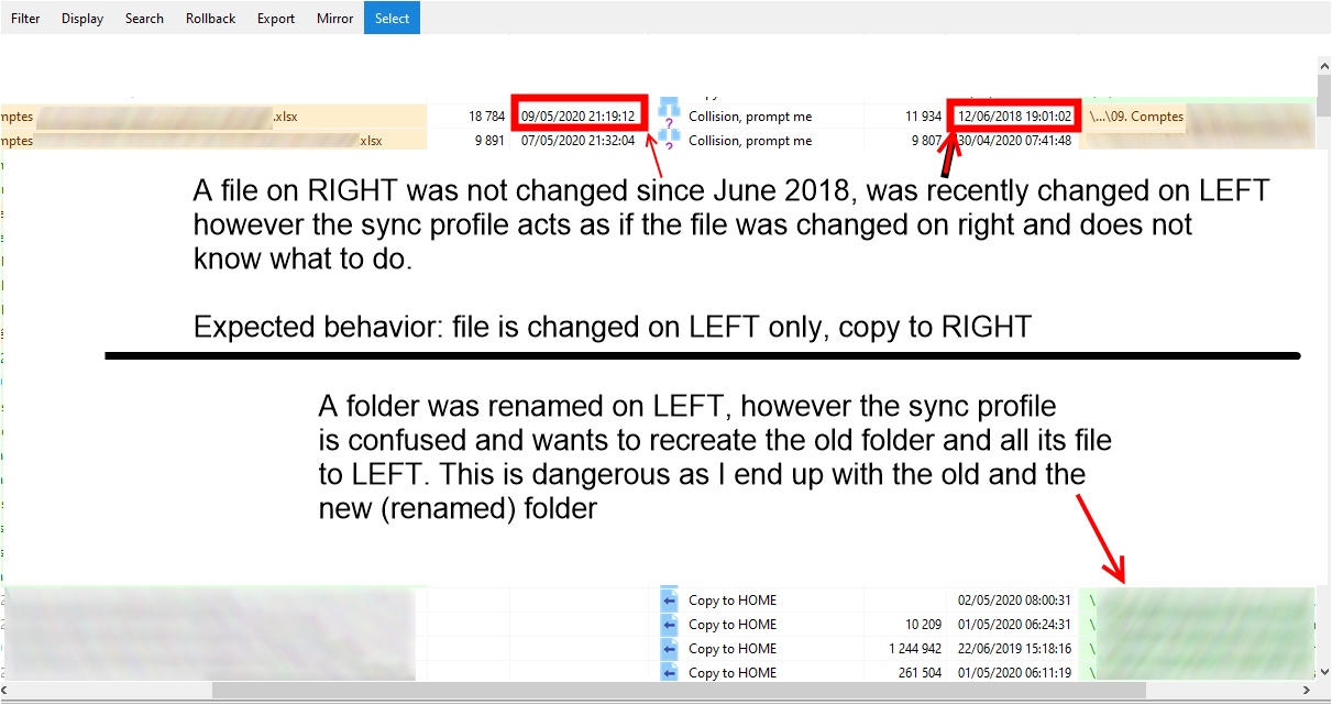

#1 File renames seem not to work. Even If I change the name of a folder on LEFT, it seems that SyncBackPro will first delete the files with the old folder name, then copy the files with the new folder name. No file rename is taking place although I have the option checked.
#2 This is the most troubling issue. A file that does not exist anymore on LEFT (because I did a folder name change for example) -> SyncBackPro will propose me to recreate the file found on RIGHT and copy it to LEFT. It kind of recreates the file on LEFT with the old folder name.
If I accept everything, I end up with having on LEFT and on RIGHT both the old folder structure and the new folder structure with several file duplicates being created by SyncBackPro.
Even if I remove the options to detect file renames, the issue #2 remains.
In the end, to go around issue #2, I have to force MIRROR ALL THE FILES TO RIGHT in the "Differences for Profile" window, to make sure that the end result meets what I expect from a SYNC profile.
In summary, the issue is that the SYNC profile tries to copy some files to LEFT while I did not make any changes on RIGHT.

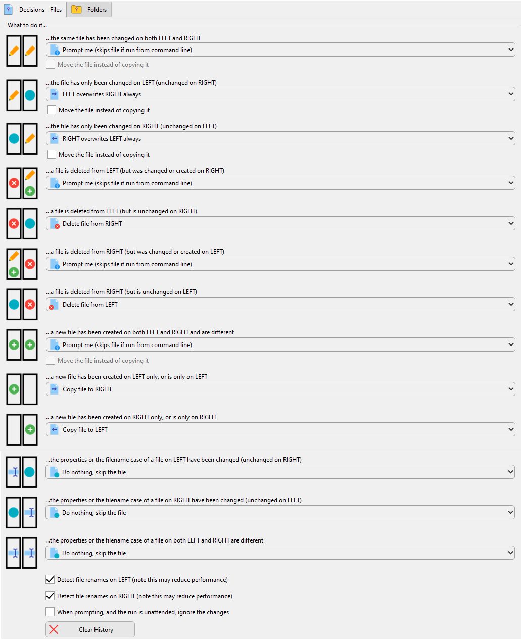

I'm attaching the file decisions, I think that it is the standard SYNC one.

Here is more details on the issues.
- WINDOW SYNCBACK PRO.jpg (231.62 KiB) Viewed 6293 times

Let's take this scenario.
LEFT and RIGHT are in sync. (point 0)
Folder 1/file1.pdf
Folder 1/file2.xlsx
Folder2/fileA.xlsx
I rename Folder 1 to Folder 3 and edit fileA on LEFT.
Actual Result (which I think is a bug in Red)
Folder 3/ ==> Copy to RIGHT ==> (comment: fine but would have preferred a file rename on RIGHT)
Folder 3/file1.pdf ==> Copy to RIGHT ==> (comment: fine but would have preferred a file rename on RIGHT)
Folder 3/file2.xlsx ==> Copy to RIGHT ==> (comment: fine but would have preferred a file rename on RIGHT)
Folder 1/ <== Copy to LEFT <== (comment: wrong, no reason why the Folder 1 structure should be replicated to LEFT)
Folder 1/file1.pdf <== Copy to LEFT <== (comment: wrong, no reason why the Folder 1 structure should be replicated to LEFT)
Folder 1/file2.xlsx <== Copy to LEFT <== (comment: wrong, no reason why the Folder 1 structure should be replicated to LEFT)
Folder2/fileA.xlsx ?? Collision Prompt me ?? (comment: wrong, file was not touched on RIGHT no reason for collision)
Expected differences window:
Folder 3/ ==> Rename on RIGHT ==> (comment: copy to RIGHT then Delete Folder 1 from RIGHT is also acceptable)
Folder 3/file1.pdf ==> Rename on RIGHT ==> (comment: copy to RIGHT then Delete Folder 1 from RIGHT is also acceptable)
Folder 3/file2.xlsx ==> Rename on RIGHT ==> (comment: copy to RIGHT then Delete Folder 1 from RIGHT is also acceptable)
Folder2/fileA.xlsx ==> Copy to RIGHT ==> (overwrite the old untouched xlsx file on RIGHT).
To your other comments, what I need is an intelligent sync, not a 1 way mirror. Because the above scenarii can work both ways (changes made on RIGHT instead of LEFT).
But the intelligent SYNC does not behave like expected. One of the main bugs is that instead of Deleting Folder 1 on RIGHT, the SYNC profile tries to re-create it on left.
For some reason it seems that all the old files on RIGHT appear to be new to SynBack Pro, when I did not make a single change. Can you investigate this specific issue?
