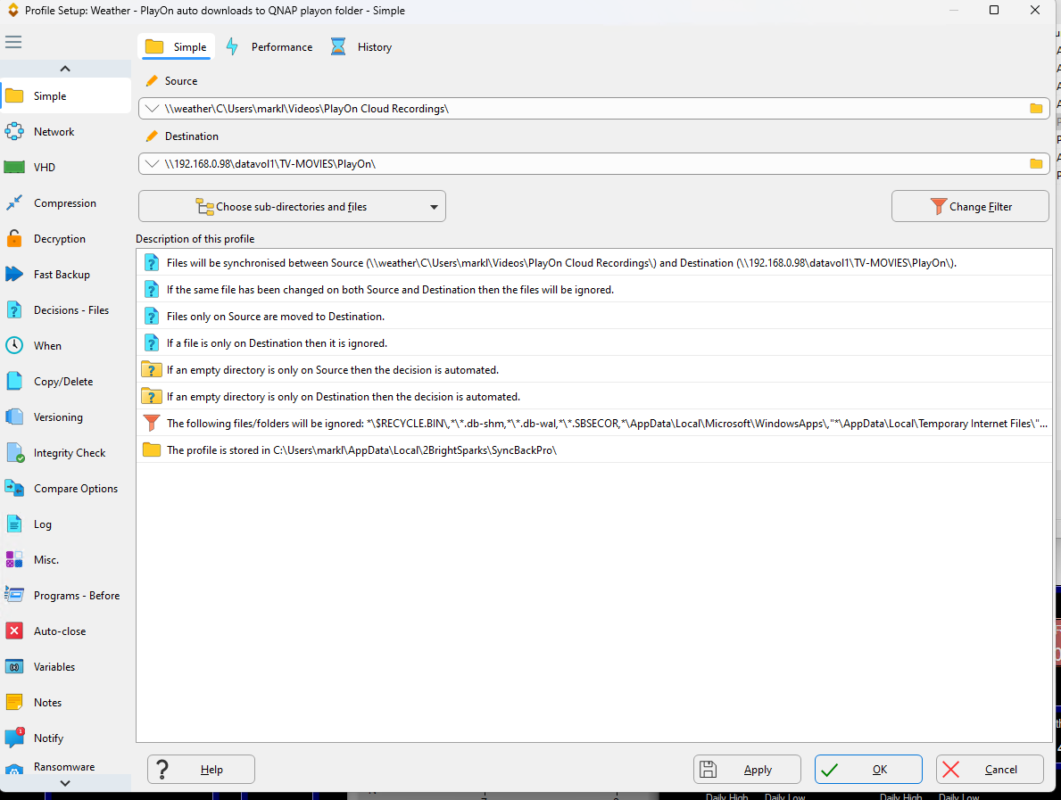

Thanks for your reply, but, I've got the profile open and cannot see the "Move or rename files" submenu anywhere. Here is a screen shot of the profile, hope that helps.
