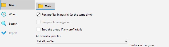

You should be able to select your Group then Modify then uncheck the box "Stop the Group if any profile fails".
Screenshot 2024-07-02 061248.jpg (20.4 KiB) Viewed 3255 times

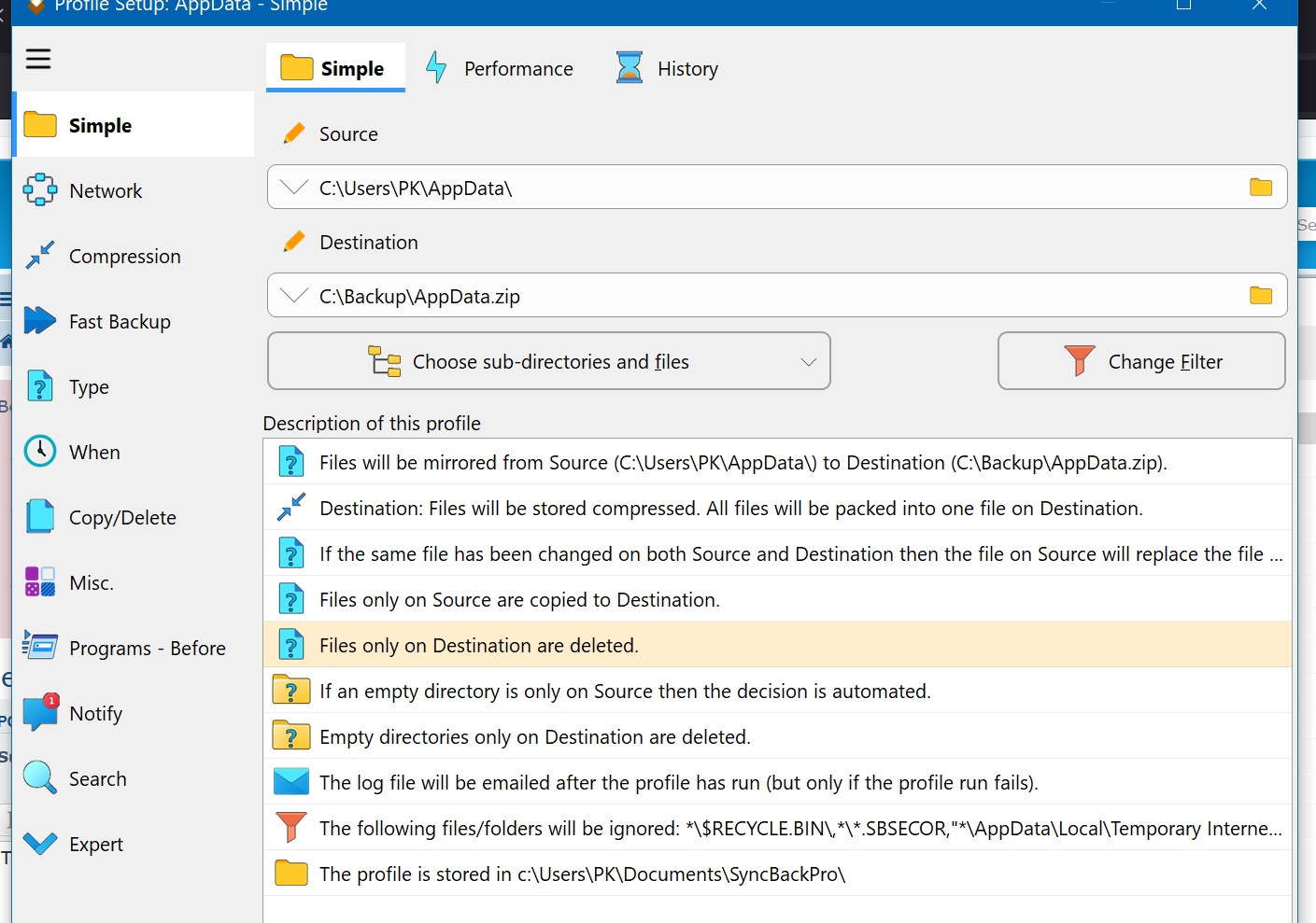

Thank you very much for your reply. However, I was unable to get to the screen shown in the image. Mine looks like this and I'm not sure where to select "Modify" or what to do to get there.
