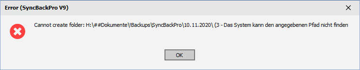

running SyncBackPro 9.4.1.1 (x64), I've set up the application to backup settings to a network share with path "H:\##Dokumente\!Backups\SyncBackPro\%DATE%\". The root exists of course, the variable should be inserted accordingly.
When existing SBP, I get an error popup for each existing profile.
The error says: "The system cannot find the given path". Don't know where the "(3" is from, but I guess this is the cause of this error message. The error message pops up more than once, as written above.
So, did I wrongly configure the backup path or is there something else I should consider?

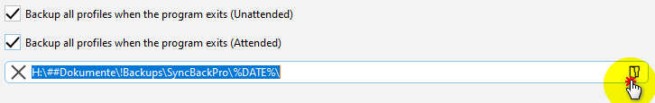

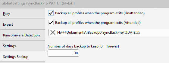

I just re-entered global settings and used the button to select the target folder:
I then selected exactly the same path as written above and added the variable %DATE% again. Right after this I closed SBP and it was successfully backing up the profiles.
Next step: I started SBP again and immediately closed it again - the error came back! The path for backing up settings is still the same of course.
As a conclusion: the path and user credentials are OK, but obviously SBP mixes sthg up after a second start and any subsequent usage!

Hi, the "(3" is actually the Windows error code (ERROR_PATH_NOT_FOUND). It's a formatting error in the error message that makes it look like part of the filename, which it isn't. We'll fix this for the next release.
The error is because elevated processes (like SyncBackPro and SyncBackSE, but not SyncBackFree because it is not elevated) do not have access rights to mapped network drives (this is a security restriction of Windows), so SyncBackPro/SE cannot see (or access) the H: drive. With a profile you can use a UNC path (\\server\share\path) and provide credentials, so it can be accessed. However, with backup of profiles there is no ability to provide that information, so unless you can access it using the UNC path (not the drive letter) without providing credentials then it cannot be used to backup profiles to.
