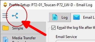

A really well hidden feature, I never before spotted the little icon with the shared settings, that only pops up in the left upper corner when it can be used...
This is the little hidden gem....
