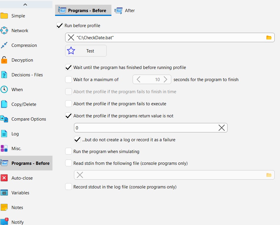

You are asking to be able to run profiles serially but not in a Group. I do not see how that would be any difference that what is currently available to run profiles serially in a Group.
I have profiles running serially in a Group and in a profile in the group using Programs/Before check the "Programs return value" to determine the profile will or will not run when the group runs. I set the return value in the .bat file with
a "If" command ...
EXIT /B 0 "Run the profile"
) ELSE (
EXIT /B 1 "Do not run the profile"

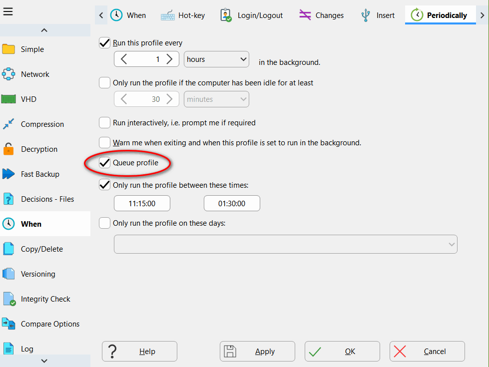

If your profiles are being run periodically then you have the option to queue the profile/group instead of running immediately, then the profile/group will not run until the currently running queued profile/group has completed.
Zodler
Posts: 14
Joined: Thu Apr 21, 2011 7:21 pm
Re: Global option to run profiles serially
Post by Zodler »
Thank you very much. That would solve the problem. I have version 8 and I don't see that option. It was introduced after 8? I have to upgrade.
