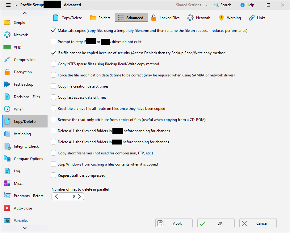

In my profile (of SBSEv8) I enabled the option
Expert--->Copy/Delete--->Advanced--->Copy file creation date & times
As I found out only the timestamps of the files were copied and NOT those of folders.
How can I tell SB-SE to copy timestamps of folder as well?
How can I now (with new timestamps of folders) "repair" the folder timestamps (=adjust them to the original timestamps)?
By the way: "Copy file creation date & times" is misleading. Not only the timestamp for creation time is copied but for modification time as well.

We have a non-default option in SyncBackSE to copy the Created date/time stamps of folders, which is under:
Modify profile > Expert mode > Copy/Delete > Folders > 'Copy sub-directory attributes and creation date (only when new directories are created)'
However, this option must be in force before/at the time the new copy was created (but it can't update the creation date/time stamps for already copied folders). There is no option to set the last modified date/time stamp of folders.

Meanwhile I tried it and found out that ONLY the CREATION timestamp of folders is copied and NOT the LAST MODIFIED timestamp.
How can copy the "last modified" timestamp of folders as well?
If I remember it well then SyncBack v6.5 provided such a feature.
Why was this removed in later versions?
Peter

Hello, I hope you're doing well and that everything is going smoothly. However, if you want to copy folder timestamps in SyncBackSE, go to your profile settings, and enable 'Copy folder dates & times' under Copy/Delete in the Advanced options. To fix folder timestamps, use a backup with the original times or a tool like BulkFileChanger.

MikeTaku wrote:
Fri Oct 18, 2024 9:47 am
There is NO such option
Have a look at the attached snapshot.
Am i blind?
Where is it?

pstein wrote:
Fri Oct 18, 2024 10:27 am
Am i blind?
Where is it?
Okay, first thing no need to be angry with me. If you can't find the copy folder timestamps in SyncBackSE, you can also try this; go to Expert > Copy/Delete > Advanced. If the option is missing, update SyncBackSE or switch to Expert Mode. If it still isn't visible, update or reinstall the software.
