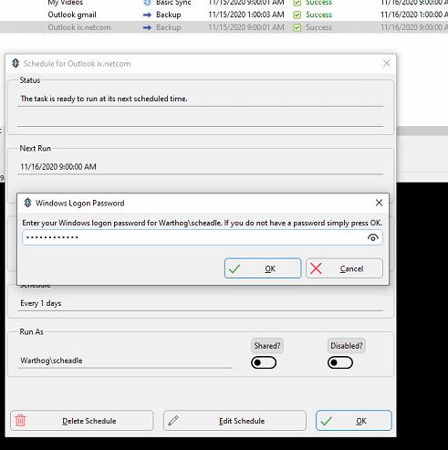

Just wanted to add some screen, file name
Syncback Issue - this one shows when I was just editing the time from 9am to 1am. Once I hit OK----
Syncback Issue1 - this is what Windows does. Then after about like 30 seconds the whole system reboots
If I go back to see if the change took, it does not.
Any help would be great
Thank you
Thank you
