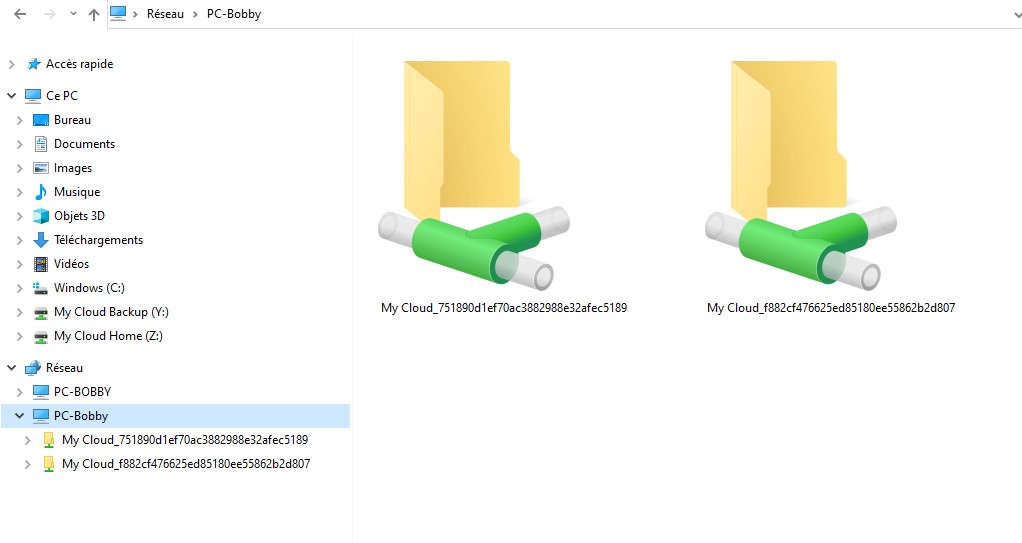

I had the same problem and I found a way to bypass the problem....
I have 2 NAS hard drive on my network and when I restart Windows, I never sure which letter is assigned to both disks. So In my profile, instead of using letter, i use the name of the disk that you found in section "network' of Files Explorer. Those names never change...
I did attach a print screen that show where to get the names which is better than my explanation...
Hope it will you.
