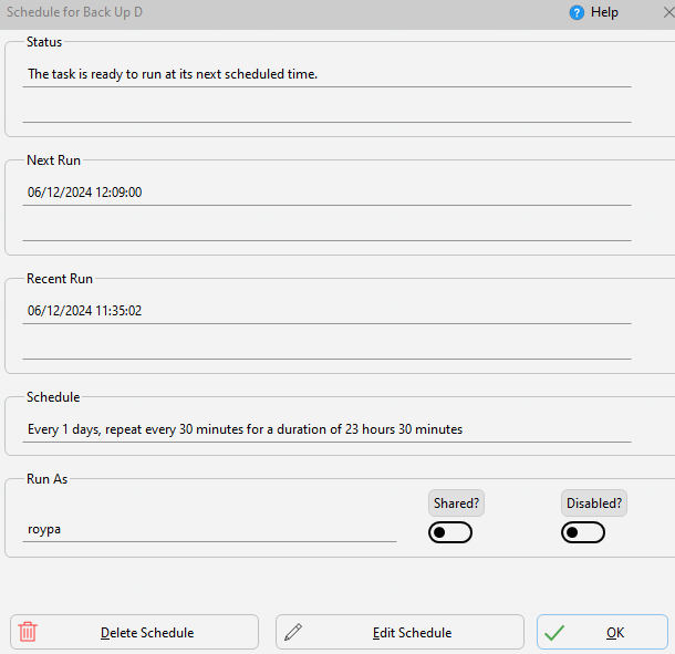

I have recently scheduled to back up my documents folder and it appears to work as I have asked, but I keep getting a message telling me that it has not backed up as I hoped and I cannot sea the reason why.
Screenshot 2024-12-06 120145.png (19.17 KiB) Viewed 7586 times
Any suggestions.

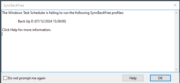

I suggest you post the actual error you are getting if possible. A screenshot of the error might be most helpful.

As requested.
Screenshot 2024-12-07 154729.png (9.06 KiB) Viewed 7550 times
Re: Says backup failed.
Thanks for the screenshot, the recommended solution is to check the box where you see "Do not prompt me again" at the bottom of the message window in your screenshot.
This situation is explained here:
https://www.2brightsparks.com/syncback/ ... ervice.htm
