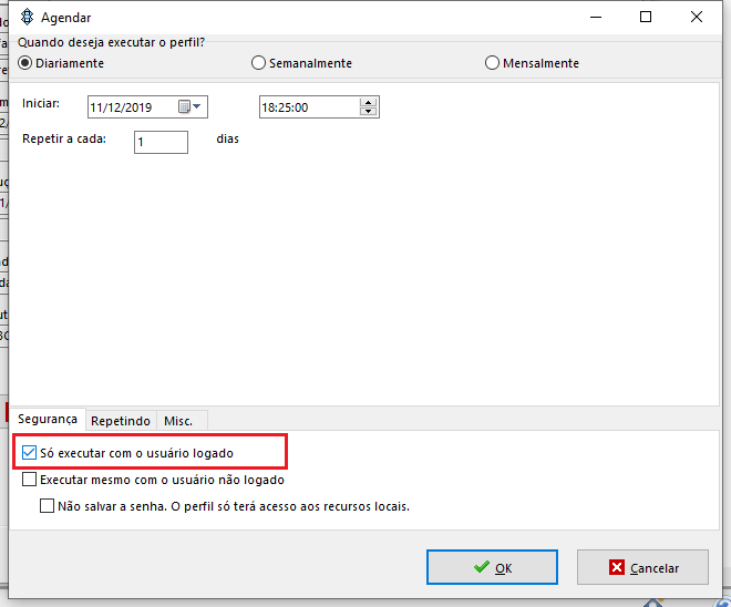

MrFormigari
- Joined: Thu Dec 12, 2019 10:30 pm
Re: SyncBack will not run as scheduled
I was having the same problem and I solved it by changing the following information.
- Captura de tela 2019-12-12 19.28.04.png (20.45 KiB) Viewed 37517 times
