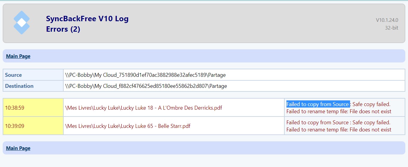

I use SBF for copying 1 NAS drive to another NAS drive and most of the time, I get an error
"Failed to copy from Source : Safe copy failed. Failed to rename temp file: File does not exist"
When I reexecute the backup, I may ou maynot get the same files. strange....
Do you know what to do ?
Thanks in advance

The problem could be your anti-malware software. As suggested in the following article you could try turning off the safe copy option in SyncBackFree.
See:
https://help.2brightsparks.com/support/ ... -temp-file
