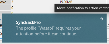

SyncBackFree prompts the user for a response about files being changed in the Taskbar Notification area when performing a normal backup. This is not new. In previous versions, these notifications were cleared when the user responded to the prompt window. In Version 9 all Notiications remain even after SyncBackFree has terminated. These notifications should be cleared when they are replied to.

In my case both V8 and V9 behave the same under Windows 10 Version 1903. Clicking on the notification will dismiss it without moving it to the Action Center, but if I click on the arrow that sits in the notification's corner then it moves it to the Action center and will stay there even after the application closes.
I see the same behavior with Microsoft Outlook itself by the way.

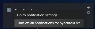

I am running Win 10 Pro 1909 and I turned off the notifications. The next time a SyncBackFree notification pops up, mouse over it and click on the settings icon (gear). There, it gives you two options, the second being Turn off all notifications for SyncBackFree.

Or you can disable notifications within SyncBack itself by modifying any profile, then under Notify options enable "Disable profile prompt notifications for ALL profiles".
