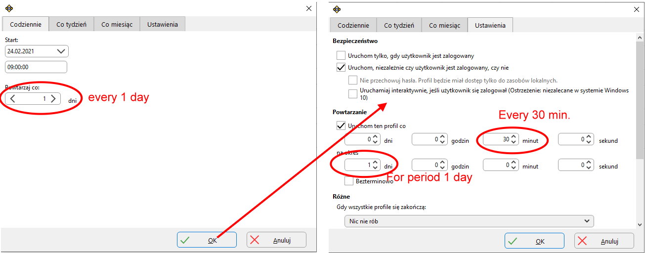

- Joined: Wed Feb 24, 2021 8:13 am
Re: Scheduling every xx minutes
I do not agree. The c) should be:Swapna wrote: ↑Fri Mar 13, 2020 5:35 amHi,
a) Configure the profile to Recur every [1] day and Repeat setting as:
b) Run this Profile every : [0] days, [0] hour, [30] minutes, [0] seconds
c) for a duration of : [0] days, [23] hours, [30] minutes, [0] seconds
d) Do not enable the 'Indefinitely' option.
Thank you
for a duration of : [1] days, [0] hours, [0] minutes, [0] seconds
And then it works
- Untitled - 1.jpg (98.5 KiB) Viewed 8338 times
