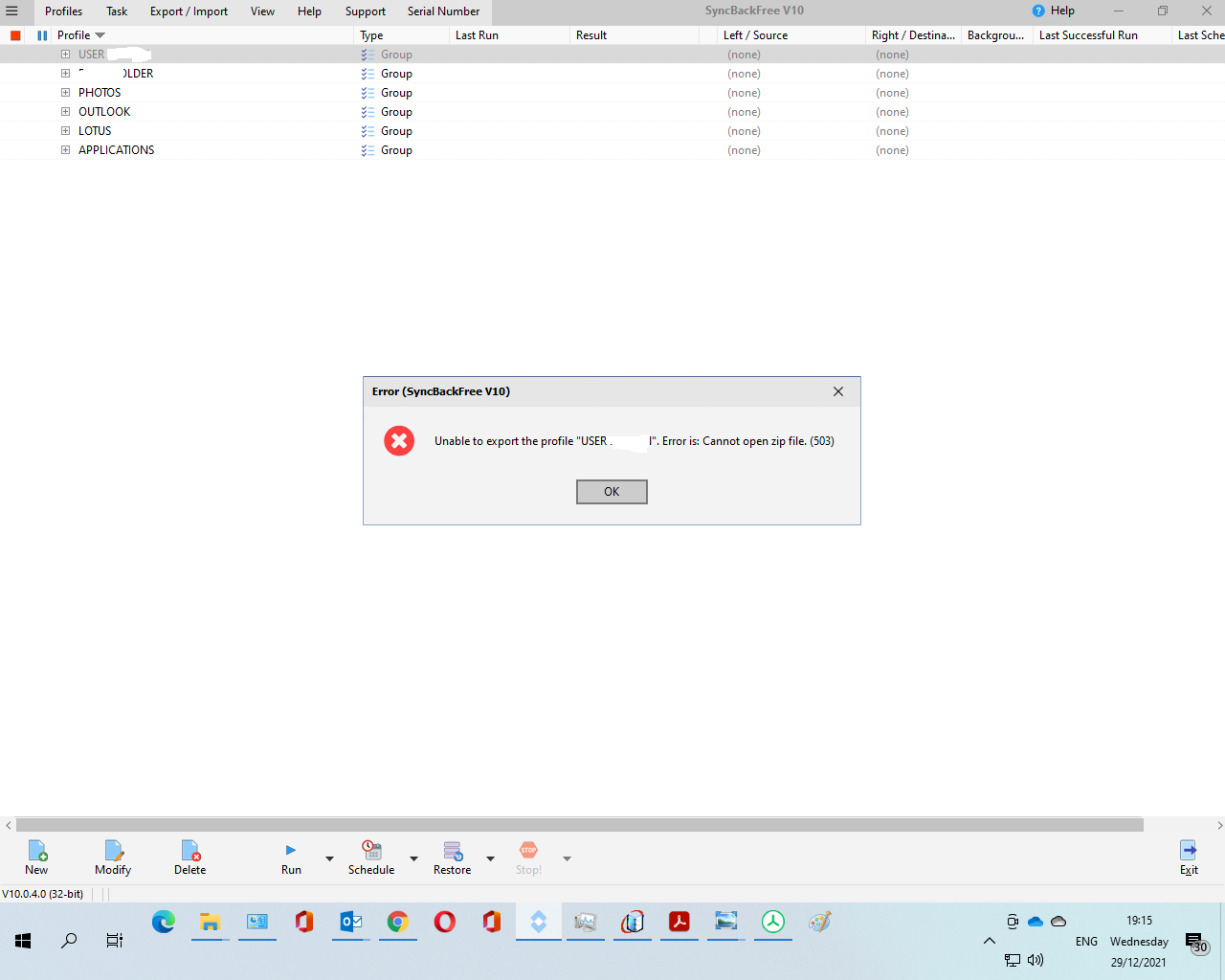

i have tried to export profiles i have created but every time i try, i see an error message
I have no idea what is going on. I have assumed that if the feature Export Profile was available in the free version then it was active.
please advise
cannot Export profile Error 503

Hello
i simply cannot understand this error message. Each profile contains zipped/compressed folders which Syncback is able to copy to another loacation without a problem.
I see the same error message with every profile in the screen shot above.
I created 2 additional profiles where one only contained images and the other excel files with no zip folders and saw the same error.
when i try and export profile, i select a profile and click on Export profile from the menu bar. I then see the following window

- Posts: 269
Re: cannot Export profile Error 503
In your attached screenshot it appears you are not selecting a "Save As" folder. As shown the exported profile is trying to save in the Program Files SyncBackFree folder which you do not have permission to use. Choose a different folder and try again.
- Posts: 5
- Joined: Sat Mar 03, 2007 9:08 pm
You are absolutely right ! The save window does not make this obvious and neither does the help articles.
